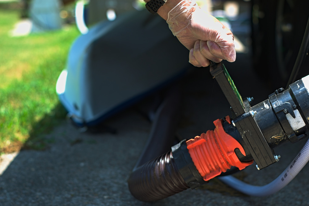

Connect your hose to the anti-backflush valve
Attach it to the sewage rinse on your RV and the other end to your freshwater source.
Slowly turn the water on
Pull the black water tank valve and run the water until it runs clear. You’ll do this step a few times until the black water tank is full. Pay attention and make sure your tank doesn’t overflow. Repeat this step until your water runs clear.
Turn the water off
Allow the remaining water to drain, then close your valve. Open the gray water tank again, and let that water drain.

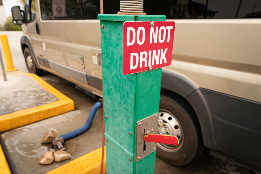

RV Dump Stations
RV dumping stations help you maintain and clean your RV’s black water tank while traveling. You can typically find them at RV parks, campgrounds, rest areas, and some gas stations. Using these stations when your black water tank is full or nearly full is essential to avoid overflows or leaks. Most RV parks allow guests to use their dumping stations for free or for a small fee. If you’re taking a long road trip, you can conveniently stop along your journey to empty your water tank. You should empty your black water tank every 3-5 days or when it is two-thirds or three-quarters full. Remember to wear gloves and follow proper hygiene practices when using a dumping station. You can safely empty and rinse your water tanks using the provided hoses and equipment at these stations. Stopping regularly to empty and clean your tank will make sure you have a pleasant and worry-free travel experience.
