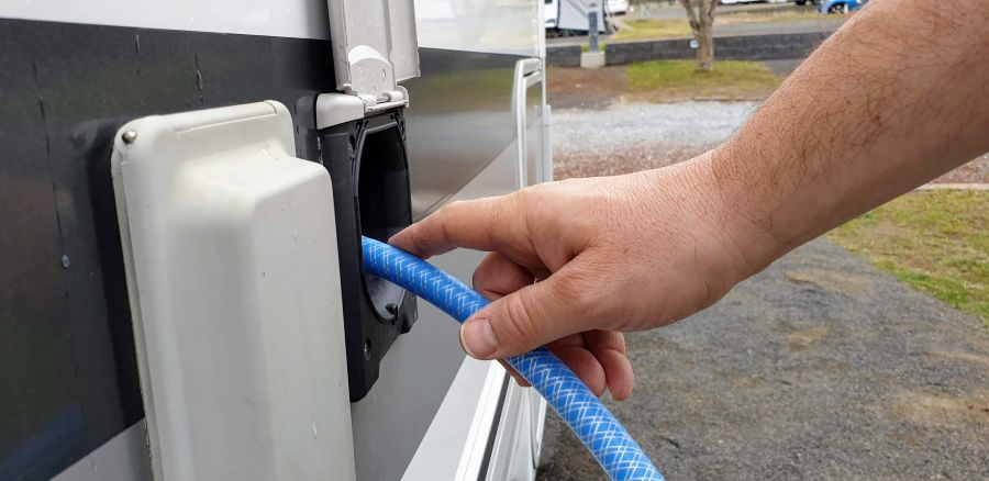

Connect a potable-water-only hose to the city water connection or begin filling the freshwater tank with clean water. Turn on the water pump if you are drawing from the tank. One fixture at a time, run fresh water through the entire system: kitchen and bathroom sinks, indoor and outdoor showers, toilet, and any washing machine or other water-using appliances. Let each run until the water is completely clear and you no longer see or smell the pink antifreeze.

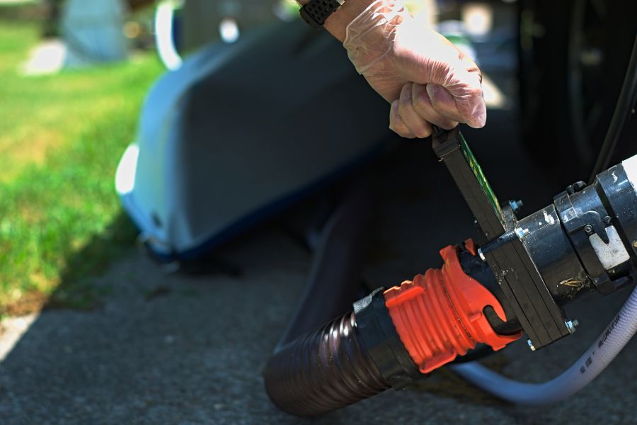

As the system flushes, the used antifreeze and water mixture will collect in the gray and black holding tanks. Once the water lines run clear, drive to an RV dump station to empty both tanks. This completes the initial antifreeze flush and prepares your water system for sanitizing.
