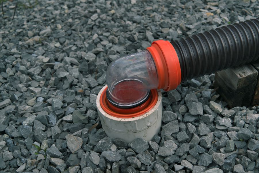

Flush Water Tanks
Once the plumbing is drained, empty and flush both the black and grey water tanks. This keeps waste and odors from settling in during storage. If you want added protection, pour a small amount of RV antifreeze into each tank after dumping. This helps protect the dump valves and any water that might still be sitting in the bottom of the tanks.
